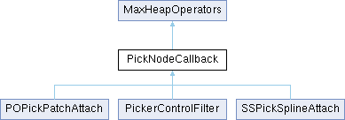

Inheritance diagram for PickNodeCallback:

Implemented in PickerControlFilter, POPickPatchAttach, and SSPickSplineAttach.
