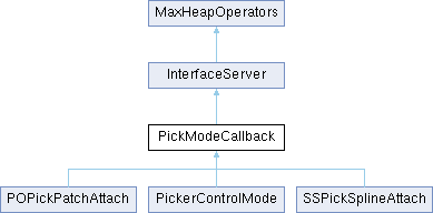

Inheritance diagram for PickModeCallback:

This class is the callback object passed to Interface::SetPickMode().
