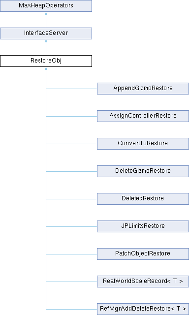

Inheritance diagram for RestoreObj:

Detailed Description
See also
Class Hold, ~{ The Undo and Redo System }~.
Description:
This class is the restore object used in the undo / redo system of 3ds Max.
