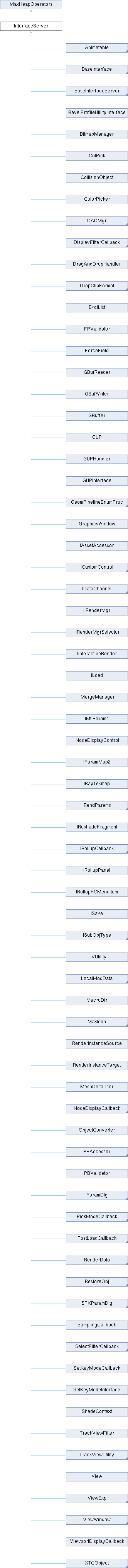

Inheritance diagram for InterfaceServer:
