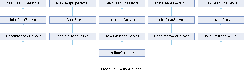

Inheritance diagram for TrackViewActionCallback:

class TrackViewActionCallback : public ActionCallback
Description:
This is the callback object for handling TrackView actions.
