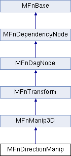

+ Inheritance diagram for MFnDirectionManip:
