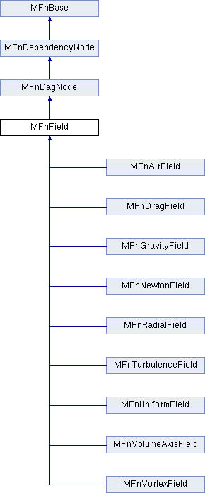

+ Inheritance diagram for MFnField:

Detailed Description
Function set for Dynamic Fields.
Function set for creation, edit, and query of Dynamic Fields.
There are several types of dynamic fields: Air, Drag, Gravity, Newton Radial, Turbulence, Uniform, and Vortex.

the class type.
Reimplemented from MFnDagNode.
Reimplemented in MFnDragField, MFnNewtonField, MFnRadialField, MFnVortexField, MFnGravityField, MFnTurbulenceField, MFnUniformField, MFnVolumeAxisField, and MFnAirField.
