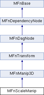

+ Inheritance diagram for MFnScaleManip:
