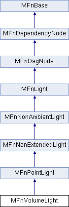

Inheritance diagram for MFnVolumeLight:Public Member Functions | |
