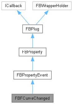

PropertyEvent: Event when a fcurve is changed. More...
#include <fbdata.h>
