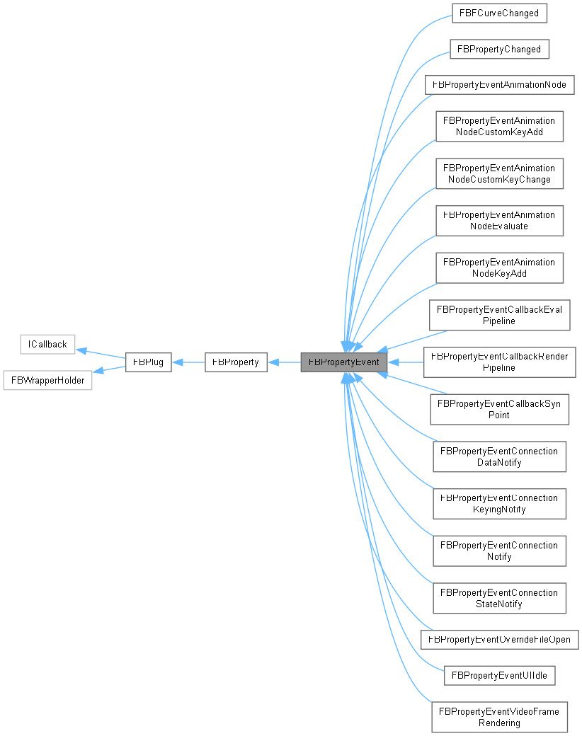

PropertyEvent: Base event class.
User could register custom callback function to FBPropertyEvent and perform necessary custom tasks.
Multiple callbacks could be registered to single event, and they will called in the reverse order of registration.
User could add python callbacks via pyfbsdk (if exposed). Those python callbacks which throws exceptions will be unregistered automatically
Definition at line 512 of file fbproperties.h.

Constructor.
virtual |
Destructor.
virtual |
Add/Remove a callback.
| pOwner | Callback owner. |
| pHandler | Callback handler. |
Reimplemented in FBPropertyEventOverrideFileOpen, FBPropertyEventAnimationNode, FBPropertyEventAnimationNodeEvaluate, FBPropertyEventAnimationNodeKeyAdd, FBPropertyEventAnimationNodeCustomKeyAdd, FBPropertyEventAnimationNodeCustomKeyChange, FBPropertyChanged, FBFCurveChanged, FBPropertyEventCallbackEvalPipeline, FBPropertyEventCallbackRenderPipeline, FBPropertyEventCallbackSynPoint, FBPropertyEventUIIdle, FBPropertyEventVideoFrameRendering, FBPropertyEventConnectionNotify, FBPropertyEventConnectionDataNotify, FBPropertyEventConnectionStateNotify, and FBPropertyEventConnectionKeyingNotify.
inlineoverridevirtual |
Get the property's type.
Reimplemented from FBProperty.
Definition at line 562 of file fbproperties.h.
References kFBPT_event.
| FBPropertyEvent * Init | ( | FBComponent * | pComponent, |
| HIRegister | pParent, | ||
| const char * | pName, | ||
| int | pType, | ||
| int | pSubType = K_INT_MAX |
Property initialization function.
| pComponent | Owner component. |
| pParent | Internal register interface of object owner. |
| pName | Name of FBPropertyEvent |
| pType | Type of event. |
| pSubType | SubType of event(default=K_INT_MAX). |
| FBPropertyEvent * InitGlobal | ( | const char * | pName, |
| const char * | pGlobalEventName | ||
Property initialization function, for global events.
| pGlobalEventName | Name of global event. |
virtual |
Invalidate parent, removing internal register parent.
