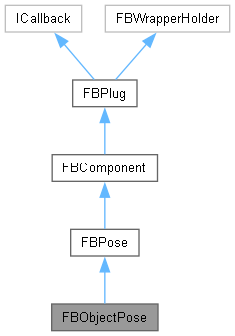

FBObjectPose class. More...
#include <fbobjectpose.h>

FBObjectPose class.
This class exposes the object used to store the pose of objects.
Definition at line 192 of file fbobjectpose.h.
