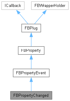

PropertyEvent: Event when a property is modified, to be used with the FBFCurveEventManager. More...
#include <fbdata.h>
