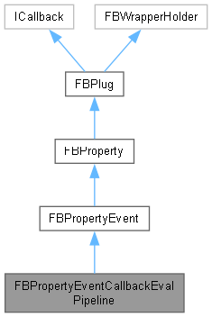

PropertyEvent: Callback at evaluation pipeline (for kFBGlobalEvalCallbackBeforeDAG, kFBGlobalEvalCallbackAfterDAG, kFBGlobalEvalCallbackAfterDeform, kFBGlobalEvalCallbackBeforePlottingFrame and kFBGlobalEvalCallbackAfterPlottingFrame) More...
#include <fbevaluatemanager.h>
Public Member Functions | |
