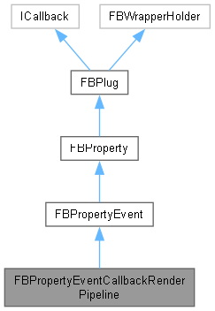

PropertyEvent: Callback at evaluation pipeline (for kFBGlobalEvalCallbackBeforeRender, kFBGlobalEvalCallbackAfterRender) More...
#include <fbevaluatemanager.h>
Public Member Functions | |
| virtual void | Add (HICallback pOwner, kICallbackHandler pHandler) |
| Add/Remove a callback. | |
| virtual void | Remove (HICallback pOwner, kICallbackHandler pHandler) |
Public Member Functions inherited from FBPropertyEvent | |
| FBPropertyEvent () | |
| Constructor. | |
| FBPropertyEvent * | Init (FBComponent *pComponent, HIRegister pParent, const char *pName, int pType, int pSubType=K_INT_MAX) |
| Property initialization function. | |
| FBPropertyEvent * | InitGlobal (const char *pName, const char *pGlobalEventName) |
| Property initialization function, for global events. | |
| virtual | ~FBPropertyEvent () |
| Destructor. | |
| virtual void | InvalidateParent () |
| Invalidate parent, removing internal register parent. | |
| virtual FBPropertyType | GetPropertyType () override |
| Get the property's type. | |
