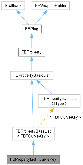

List of FCurveKey. More...
#include <fbdata.h>
Public Member Functions | |
| virtual void | RemoveAt (int pIndex) |
| Remove an FCurveKey. | |
| virtual FBFCurveKey | operator[] (int pIndex) |
| Overloaded [] operator. | |
| virtual int | GetCount () |
| Get a count of the number of keys in list. | |
