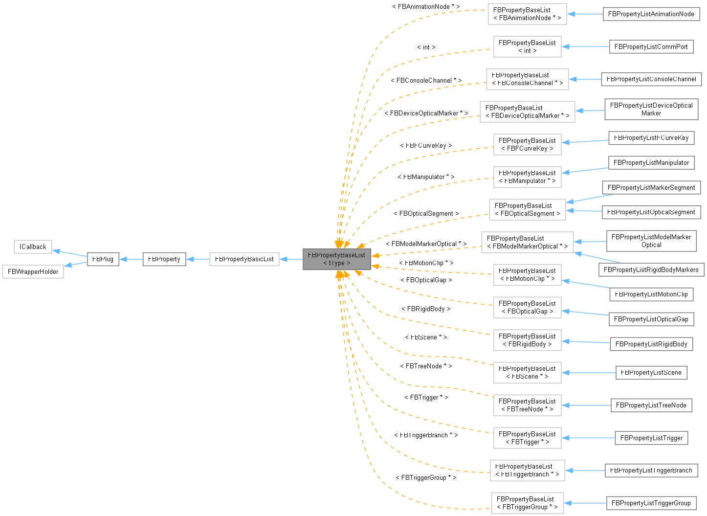

Public Member Functions | |
| FBPropertyBaseList () | |
| Constructor. | |
| ~FBPropertyBaseList () | |
| Destructor. | |
| FBPropertyBaseList (HIObject pParent, const char *pName) | |
| Constructor. | |
| virtual int | Add (tType pItem)=0 |
| Add a property to the list. | |
| virtual tType | operator[] (int pIndex)=0 |
| [] operator overload. | |
| virtual int | Find (tType pItem) |
| Locate a property in the list. | |
| virtual int | Remove (tType pItem) |
Remove pItem from the list. | |
| virtual tType | GetAt (int pIndex) |
Get a property at pIndex. | |
