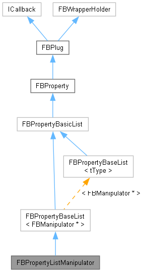

PropertyList: Manipulator. More...
#include <fbmanipulator.h>
Public Member Functions | |
| virtual FBManipulator * | operator[] (int pIndex) |
| Get the manipulator at a given index. | |
| virtual int | GetCount () |
| Get the number of manipulators. | |
Public Member Functions inherited from FBPropertyBaseList< FBManipulator * > | |
| FBPropertyBaseList () | |
| Constructor. | |
| FBPropertyBaseList (HIObject pParent, const char *pName) | |
| Constructor. | |
| ~FBPropertyBaseList () | |
| Destructor. | |
| virtual int | Add (FBManipulator * pItem)=0 |
| Add a property to the list. | |
| virtual FBManipulator * | operator[] (int pIndex)=0 |
| [] operator overload. | |
| virtual int | Find (FBManipulator * pItem) |
| Locate a property in the list. | |
| virtual int | Remove (FBManipulator * pItem) |
Remove pItem from the list. | |
| virtual FBManipulator * | GetAt (int pIndex) |
Get a property at pIndex. | |
Public Member Functions inherited from FBPropertyBasicList | |
| FBPropertyBasicList () | |
| Constructor. | |
| FBPropertyBasicList (HIObject pParent, const char *pName) | |
| Constructor. | |
| FBProperty * | Init (void *pParent, const char *pName) |
| Initialization function. | |
| void | RemoveAll () |
| Remove all properties from the list. | |
| virtual int | GetCount ()=0 |
| Get the number of properties in the list. | |
| virtual void | RemoveAt (int pIndex)=0 |
Remove property at pIndex. | |
| virtual bool | IsList () |
| Is this a list? | |
Public Member Functions inherited from FBProperty | |
| FBProperty () | |
| Constructor. | |
| void | SetEnable (bool pValue) |
| Set property enable status. | |
| const char * | GetName () |
| Get the property's name. | |
| void | SetName (const char *pName) |
| Set the property's name. | |
| virtual FBPropertyType | GetPropertyType () |
| Get the property's type. | |
| const char * | GetPropertyTypeName () |
| Get the property's type name. | |
| virtual KDataType * | GetDataType () |
| Get the property datatype pointer. | |
| virtual void | SetData (void *pData) |
| Set the value of the property, passing the type as an argument. | |
| virtual void | GetData (void *pData, int pSize, FBEvaluateInfo *pEvalInfo=NULL) const |
| Get the value of a property. | |
| int | AsInt () |
| Get the property as an integer. | |
| bool | SetInt (int pInt) |
| Set the property from an integer. | |
| virtual const char * | AsString (FBDataAsStringFlag pFlag=kFBDataAsStringUI) |
| Get the property value as a string. | |
| virtual bool | SetString (const char *pString) |
| Set the property value from a string. | |
| const char * | OriValueAsString () |
| Get the property original value (before any modification) as string. | |
| bool | IsAnimated () const |
| Get the property animated flag status. | |
| bool | OriIsAnimated () const |
| Get the property original animated flag status (before any modification) | |
| Verify if property is of this type. | |
| virtual bool | IsAnimatable () |
| bool | IsInternal () const |
| bool | IsUserProperty () |
| bool | IsTextureConnectableProperty () |
| bool | IsReferenceProperty () |
| bool | IsMinClamp () |
| Indicate if minimum value clamping will be applied on user input value. | |
| bool | IsMaxClamp () |
| Indicate if maximum value clamping will be applied on user input value. | |
| bool | IsTemporaryProperty () |
| Indicate if a property was created on retrieve because it didn't exist. | |
| bool | AcceptTemporaryProperty (const char *pEnumList[]=NULL, fbExternalGetSetHandler pGet=NULL, fbExternalGetSetHandler pSet=NULL) |
| Accept a temporary property as a dynamic property. | |
| bool | IsObjectList () |
| Indicate if is an instance of FBPropertyListObject. | |
| virtual bool | IsReadOnly () |
| Is property read-only? | |
| virtual const char * | EnumList (int pIndex) |
| Return the string of an enum value. | |
| FBStringList * | GetEnumStringList (bool pCreateIt=false) |
| String list for enum properties. | |
| void | NotifyEnumStringListChanged () |
| Notify system that the enum list was modified. | |
| void | ModifyPropertyFlag (FBPropertyFlag pFlag, bool pValue) |
| ModifyPropertyFlag. | |
| FBPropertyFlag | GetPropertyFlags () |
| GetPropertyFlags. | |
| bool | GetPropertyFlag (FBPropertyFlag pFlag) |
| GetPropertyFlag. | |
| void | SetMinMax (double pMin, double pMax, bool pForceMinClamp=false, bool pForceMaxClamp=false) |
| SetMinMax. | |
| void | SetMin (double pMin, bool pForceMinClamp=false) |
| SetMin. | |
| void | SetMax (double pMax, bool pForceMaxClamp=false) |
| SetMax. | |
| double | GetMin () |
| GetMin. | |
| double | GetMax () |
| GetMax. | |
| void * | GetParent () |
| Get the parent of the object. | |
| int | GetSubMemberCount () const |
| GetSubMemberCount. | |
| bool | AllowsLocking () const |
| AllowsLocking. | |
| bool | HasSomethingLocked () const |
| HasSomethingLocked. | |
| bool | IsLocked () const |
| IsLocked. | |
| bool | IsMemberLocked (int pIndex) const |
| IsMemberLocked. | |
| void | SetLocked (bool pLocked) |
| SetLocked. | |
| void | SetMemberLocked (int pIndex, bool pLocked) |
| SetMemberLocked. | |
| FBProperty * | GetReferencedProperty () |
| Get the referenced property, in the case of this property is a reference property (see the IsReferenceProperty() method). | |
Public Member Functions inherited from FBWrapperHolder | |
| FBScriptWrapper * | GetWrapper () |
| Return the wrapper interface of this FBObject. | |
| void | AddWrapper (FBScriptWrapper *) |
| void | RemoveWrapper (FBScriptWrapper *) |
Additional Inherited Members | |
Definition at line 242 of file fbmanipulator.h.
