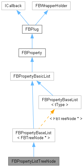

PropertyList of nodes in the tree view. More...
#include <fbcontrols.h>
Definition at line 1864 of file fbcontrols.h.
virtual |
Add a property to the list.
| pItem | Property to add. |
Implements FBPropertyBaseList< FBTreeNode * >.
virtual |
Get the number of properties in the list.
Implements FBPropertyBasicList.
virtual |
[] operator overload.
| pIndex | Index of property to access. |
virtual |
Remove property at pIndex.
| pIndex | Index where property is to be removed. |
