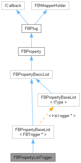

PropertyList: Trigger More...
#include <fbtrigger.h>
Public Member Functions | |
| virtual int | Add (FBTrigger *pItem) |
| Add a trigger to the property list. | |
| virtual void | RemoveAt (int pIndex) |
Remove property at pIndex. | |
| virtual FBTrigger * | operator[] (int pIndex) |
| [] operator overload. | |
| virtual int | GetCount () |
| Get the number of properties in the list. | |
Definition at line 91 of file fbtrigger.h.
