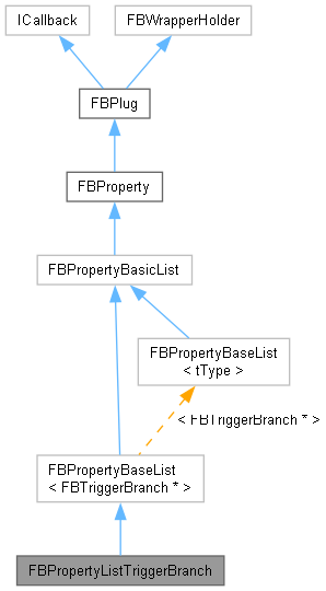

PropertyList: TriggerBranch More...
#include <fbtrigger.h>
Public Member Functions | |

Public Member Functions inherited from FBPropertyBaseList< FBTriggerBranch * > | |

Public Member Functions inherited from FBPropertyBasicList | |

Public Member Functions inherited from FBProperty | |

Public Member Functions inherited from FBWrapperHolder | |

Protected Member Functions inherited from FBPlug | |
Definition at line 125 of file fbtrigger.h.
