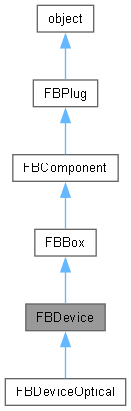

Base Device class. More...
#include <pyfbsdk_generated.h>

Base Device class.
Cannot be instantiated from Python.
