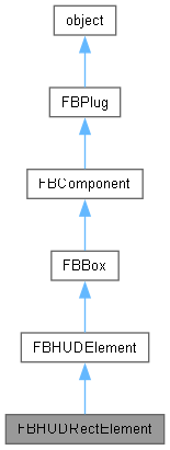

Heads Up display. More...
#include <pyfbsdk_generated.h>
Public Member Functions | |
| FBHUDRectElement (str pName) | |
| Constructor. | |
