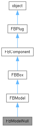

Null object class. More...
#include <pyfbsdk_generated.h>

Null object class.
| FBModelNull | ( | str | pName | ) |
Constructor.
| pName | Name of null. |
| float Size |
Read Write Property: Size (not related to scaling).
