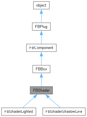

Shader class. More...
#include <pyfbsdk_generated.h>

Shader class.
