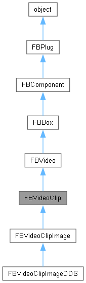

Video clip media class. More...
#include <pyfbsdk_generated.h>

Public Member Functions inherited from FBVideo | |
| FBVideo (str pName) | |
| Constructor. | |
Public Member Functions inherited from FBBox | |
| FBBox (str pName) | |
| Constructor. | |
