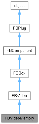

FBVideoMemory allow external media source (which can't be supported by MoBu natively)
User could create / update OGL texture (GL_TEXTURE_2D type) externally, and pass in GL texture object id to TextureOGLId property.See "Scripts/Samples/Video/VideoMemory.py" for usage example.

Public Member Functions inherited from FBVideo | |
| FBVideo (str pName) | |
| Constructor. | |
