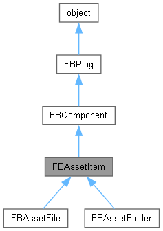

Inheritance diagram for FBAssetItem:

Detailed Description
Base class for all managed assets.
