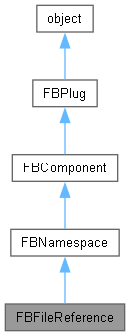

Inheritance diagram for FBFileReference:
