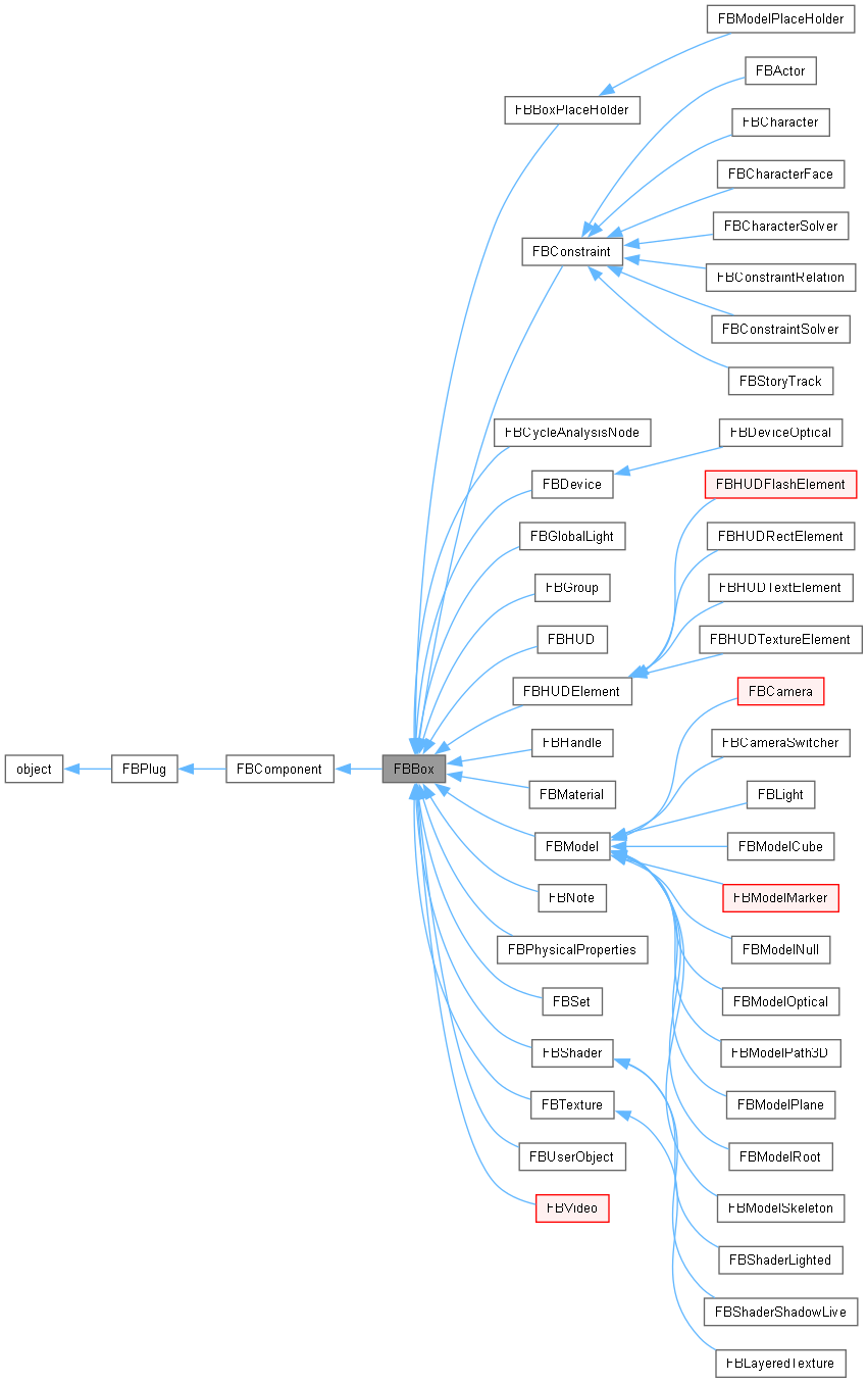

| FBBox (str pName) |
| Constructor.
bool | AnimationNodeDestroy (FBAnimationNode pAnimationNode) |
| Destroy an animation node.
FBAnimationNode | AnimationNodeInGet () |
| Get the (IN/OUT) animation node for this box.
bool | AnimationNodeIsUserData (FBAnimationNode pAnimationNode) |
| Is the animation node user data?
FBAnimationNode | AnimationNodeOutGet () |
str | FbxGetObjectSubType () |
| Returns the class sub type inherited by the class of an object, for example: 'Relations', 'Parent-Child', 'Number to Vector', 'Shot'.
str | FbxGetObjectType () |
| Returns the class type inherited by the class of an object, for example: 'Box', 'Constraint', 'TimelineXTrack'.
FBAnimationNode | GetInConnector (int pIndex) |
| Get the animation node input associated with the given index.
int | GetInConnectorCount () |
| Get the number of animation node inputs for this box.
FBAnimationNode | GetOutConnector (int pIndex) |
| Get the animation node output associated with the given index.
int | GetOutConnectorCount () |
| Get the number of animation node outputs for this box.
