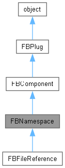

Objects Containing class.
This class is an interface to manipulate object's containing in the scene.
