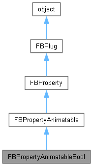

Inheritance diagram for FBPropertyAnimatableBool:
