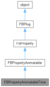

FBPropertyAnimatableTime Class Reference
#include <pyfbsdk.h>
Inheritance diagram for FBPropertyAnimatableTime:
Public Attributes
FBTime Data
