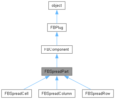

Spreadsheet part. More...
#include <pyfbsdk.h>

Spreadsheet part.
Due to protected constructor, this can only be created by a child object.
