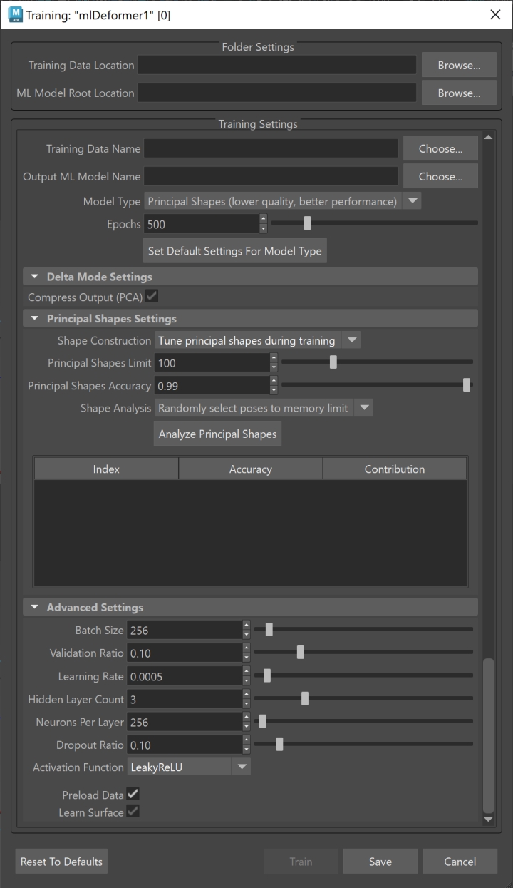

The ML Deformer Training settings is where you configure how the Machine Learning model should be trained on the training data. See ML Deformer Export Training Data window for details on how to export the training data.
To open the ML Deformer Training settings
icon.

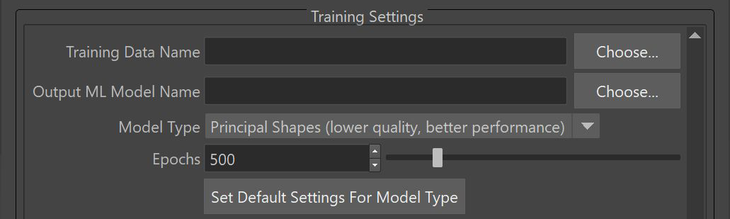

This section lets you set the path to your exported training data and trained models.
Model Type dropdown allows you to select the training approach for your ML Deformer. The selected model type determines the underlying methodology used for learning and approximating deformations.
Principal Shapes (lower quality, better performance): Configures the ML Deformer to compute a series of base delta poses for target deformations relative to the rest pose, rather than evaluating per-vertex deltas. This method accelerates training and evaluation but sacrifices accuracy.
For steps on how to use Principal Shapes, see Create ML Deformer training data using Principal Shapes.
Delta Mode (default, higher quality, slower performance): Directly predicts deformation deltas using the neural model. This approach yields superior quality with more detailed deformations but results in larger model sizes and slower training/inference times. It is the default when Principal Shapes are inactive.
PCA Mode (balanced quality and performance): Applies Principal Component Analysis (PCA) to Delta Mode outputs to compress the deformation data. This hybrid method maintains better quality than Principal Shapes while improving performance over raw Delta Mode, positioning it as a middle-ground solution.
Click this button to automatically configure recommended settings for the selected model type. These presets are intended to streamline setup and ensure optimal results.
Note: You can override these defaults as needed for your specific workflow.

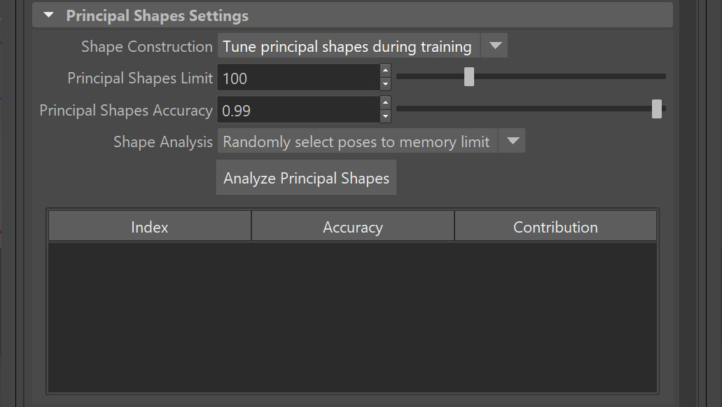

Note: Principal Shapes functionality is enabled when Principal Shapes (lower quality, better performance) is selected from the Model Type dropdown.
Principal Shapes are similar to blend shapes: to create the final result, they have associated weights that are blended together. When Principal Shapes are added to the base, they recreate the target deformation. That way, rather than training to approximate deltas, the ML Deformer uses the Principal Shapes to map the control values to these weights.
Using Principal Shapes is useful because the number of weights to learn are smaller than the number of deltas, making the resulting ML model quicker to learn and evaluate. (You may need to reduce the neurons per layer to avoid overfitting.)
Principal Shapes are calculated from training poses using singular value decomposition.
The manner in which the deformer learns to reproduce weights from principal shapes.
Fixed principal shapes: Forces the model to reproduce weights based on learnings from SVD analysis.
Tune principal shapes during training: Parameterizes the principal shapes, allowing the model to adjust them during training. This method takes longer and requires more memory, but can potentially improve results (especially if not all the training poses fit the SVD analysis). This is the default.
The maximum number of Principal Shapes to generate. This value acts as a hard limit, so the computation uses only up to this many shapes even if they do not reach the desired accuracy. An error message appears if there are more samples than deltas in the training data.
The level of accuracy that the combination of principal shapes should achieve across the sample poses. The ML Deformer then generates the number of Principal Shapes required to recreate the target deformations to meet this level of accuracy.
Note: This is the accuracy using perfect weight values, so the result from the trained model will be less accurate.

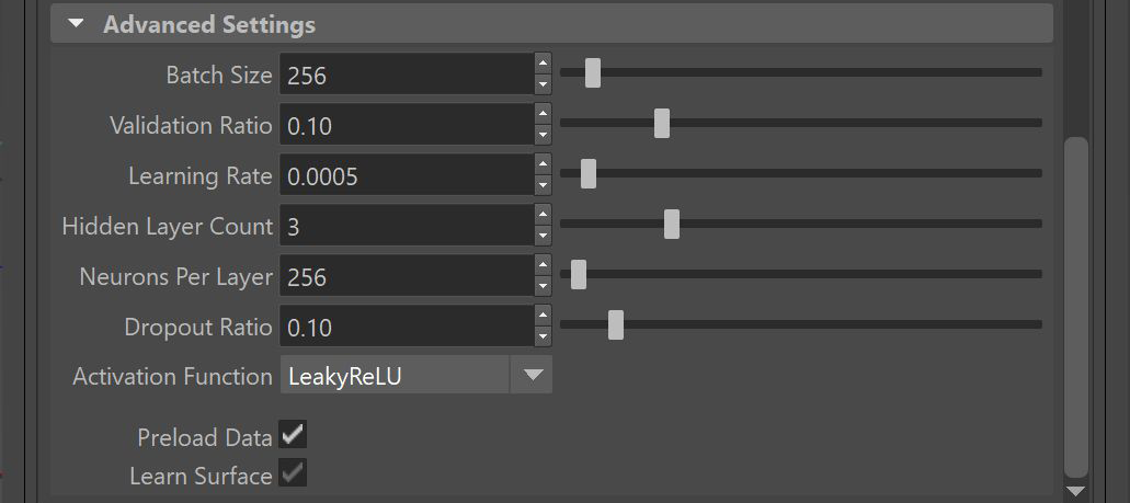

Specify a size for the "batches" that the data set is divided into. The batches are loaded into memory together, so you need enough RAM (and VRAM, if using the GPU) to support the specified batch size.
Specify the percentage of the training data samples that should be set aside for validation. The validation set is a random sampling of the training data that will not be used to train. It provides a useful indication of how well the model performs on data it hasn't seen, and can also be used to check for overfitting.
Configure how large a learning "step" the model must take per batch to adjust itself based on the results of that batch. Smaller values require more epochs to train, and can become overloaded, while larger values are more chaotic and may not produce a good approximation.
The number of layers in the neural network, not including the input and output layers. Currently, all the settings are applied uniformly to each hidden layer.
The number of artificial neurons that should exist in each layer of the model. These neurons take a set of input values from the layer above and produce an output value. Increasing the number of neurons lets the model learn a larger variety of deformations.
Use the Dropout Ratio to help prevent overfitting. When using Dropout Ratio, a fraction of the inputs set by the ratio, for each layer, is set to zero during training.
Choose the function to apply to the sum of a neuron's inputs to generate an output. These functions introduce non-linearity to the output which allows the model to learn nonlinear relationships between the inputs and outputs.
Activate to load all of the training data into memory, instead of loading it in batches, during the training process. Enabling Preload Data is recommended if your training data set is able to fit entirely in memory, as this makes the training process significantly faster.
Activate to train the deformer with additional vertex frames, rather than having the model guess the deltas and the surface. This can improve noisy results. To use it, make sure that Delta Mode is set to Surface and Export Surface Information is enabled in the Export Training Data settings.
