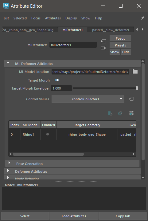

ML Deformer Attributes
ML Model Location
Path to the folder containing trained models.
Target Morph
Toggle visualization of the Target deformation (the "goal" for the ML Deformer to approximate.)
Typically, when you are finished animating your scene, you will turn on Target Morph and set the Envelope to 1.0 to reactivate the original high quality deformation for final renders.
Target Morph Envelope
Note: This envelope slider is active only if you turn on the Target Morph option.
Lets you adjust the morph (in %) between the trained approximation and the Target.
Control Values
Lets you Select, Create, or Assign a Control Collector.
You can also click Select Control Collector to highlight the collector in the Node Graph. A Control Collector specifies which inputs are passed into the ML Model. See the Control Collector attributes.
ML Deformer Attributes Table
Index
The placement in the array.

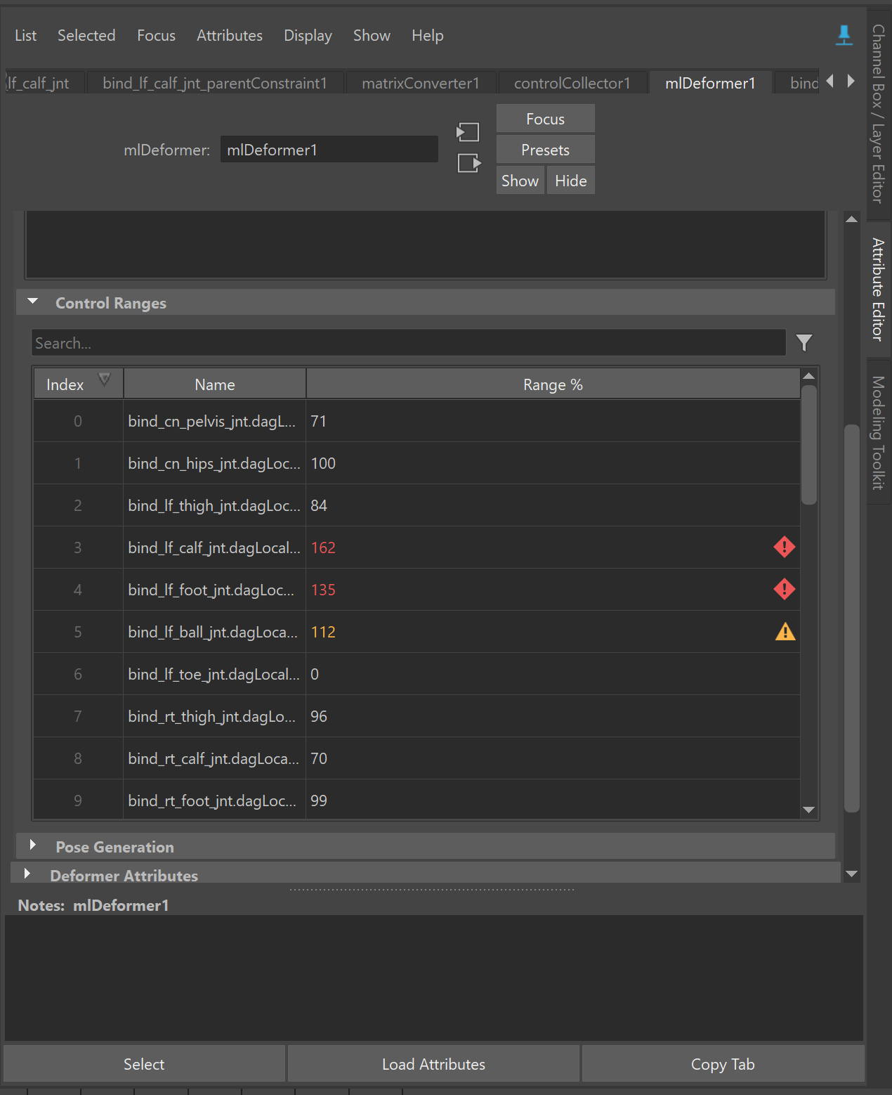

Control Ranges Table
The ML Deformer Control Ranges Table
The Control Ranges table displays the list of controls linked to the deformer and the value ranges they operate within.
The table compares current control values to the trained range from all active deformation managers. If a control value is outside the original training range, the Range % will change color and the deformation results may be unpredictable. A range of 100% or lower indicates the control value is within the trained range. Any value above 100% indicates the control is outside its trained range and may produce poor results. If multiple models are active on a single ML Deformer node (i.e. when working with multiple geometries), the table will use the most restrictive range across all models.
Note: Use this table to determine when retraining is required to accommodate new control values.
