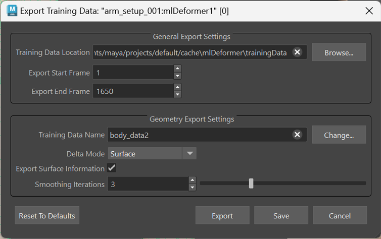

General Export Settings
This area of the ML Deformer Export Training Data window lets you set the export location and what frame range of the scene should be used for the training set.
Training Data Location
Click Browse to navigate to a folder where you want to save the training data. This can be a temporary directory as the training data is not needed once the model is trained, except if you want to retrain it with the same data (for example, to test different training settings).
Export Start Frame/Export End Frame
Specify the range of the animation that you want to use for creating the training data. The more frames used for training, the more accurate the resulting approximation of the deformation is likely to be. However, the larger the range of animation, the slower the training and export process becomes.
Geometry Export Settings
This area of the ML Deformer Export Training Data window lets you specify how the exported geometry should be represented for processing by the Machine Learning model.
Training Data Name
Enter a name for the folder that will contain the exported training data. Click Change to reuse a folder from a previously exported training data set. The folder will be given a suffix of .mltd for easier identification of its purpose, for example, using "test" creates a folder called test.mltd in the specified directory.
Tip: Hover over Training Data Name or the Change button to see information about the Training Data, such as count, frame range, and so on.
Delta Mode
Set a mode for how the difference between the base and target geometry is represented in the exported data. Specifically, the "delta" between the original, "Source", geometry and the complex "Target" geometry being approximated. The difference between the Target and Source geometry is what ML Deformer is ultimately trying to learn and predict. Select from the following modes to choose different options for how the Delta is calculated and represented.
Note:
  • Depending on the rig, setting the Delta Mode to Surface may produce artifacts and incorrect jagged deformations in some cases. This happens when the surface vertex frames aren't calculated consistently, often due to overlapping vertices in certain poses. It's possible the results can be improved if the bad poses are removed from the training set. However, the ML Deformer will still perform poorly on those and similar poses after training.
  • When trained across a large number of controls, the ML model tends to learn incorrect associations between controls and deformations in unrelated parts of the mesh. Training on poses that trigger fewer controls at once can help with this issue.
Offset
Use Offset as a last resort for troubleshooting when you are not satisfied with the results, as it has difficulty with long joint chains.
Based on Local rotation, Offset uses the object-space difference between the vertex position before deformation and after deformation for the approximation. Offset mode avoids potential problems with complex Delta calculations, but is "harder", that is, more work for the ML model to learn.
Surface
Surface mode represents the Delta in terms of displacement along the surface of each vertex. It ignores the parent transformation(s) and is recommended for the approximation of deep joint hierarchies. Surface mode, the default setting, generally produces good results. However, at times, such as when vertices overlap, Surface mode may produce unwanted artifacts, which you can minimize with the Smoothing Iterations value.
Export Surface Information
Use the Export Surface Information setting to include additional vertex frames with the exported data. Use in conjunction with the Learn Surface setting to improve noisy training results.
Use the Smoothing Iterations setting to reduce artifacting when using the Surface Delta Mode. If the Smoothing Iterations value is greater than 0, a Delta mush algorithm smooths the geometry during export.
Reset to Defaults
Restores the original settings of the Export Training Data window.
Export
Creates ML Deformer training data using the settings specified in this window. When complete, the exported data will be given the name specified under "Training Data Name", allowing you to distinguish it from others and to switch between training sets when training the Machine Learning model later.
Save
Click Save to save the current settings in the Export Training Data window.
