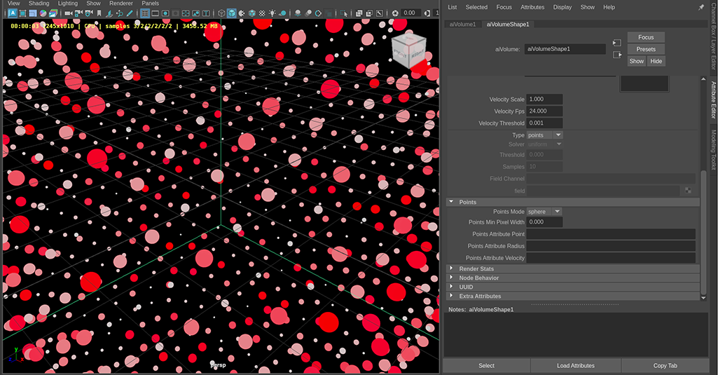

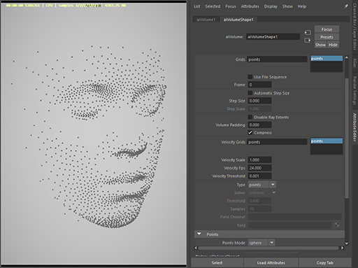

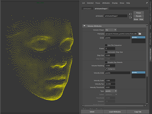

OpenVDB points support in the aiVolume node
You can now load VDB files that contain points data and render them as Arnold points primitives (MTOA-2234)

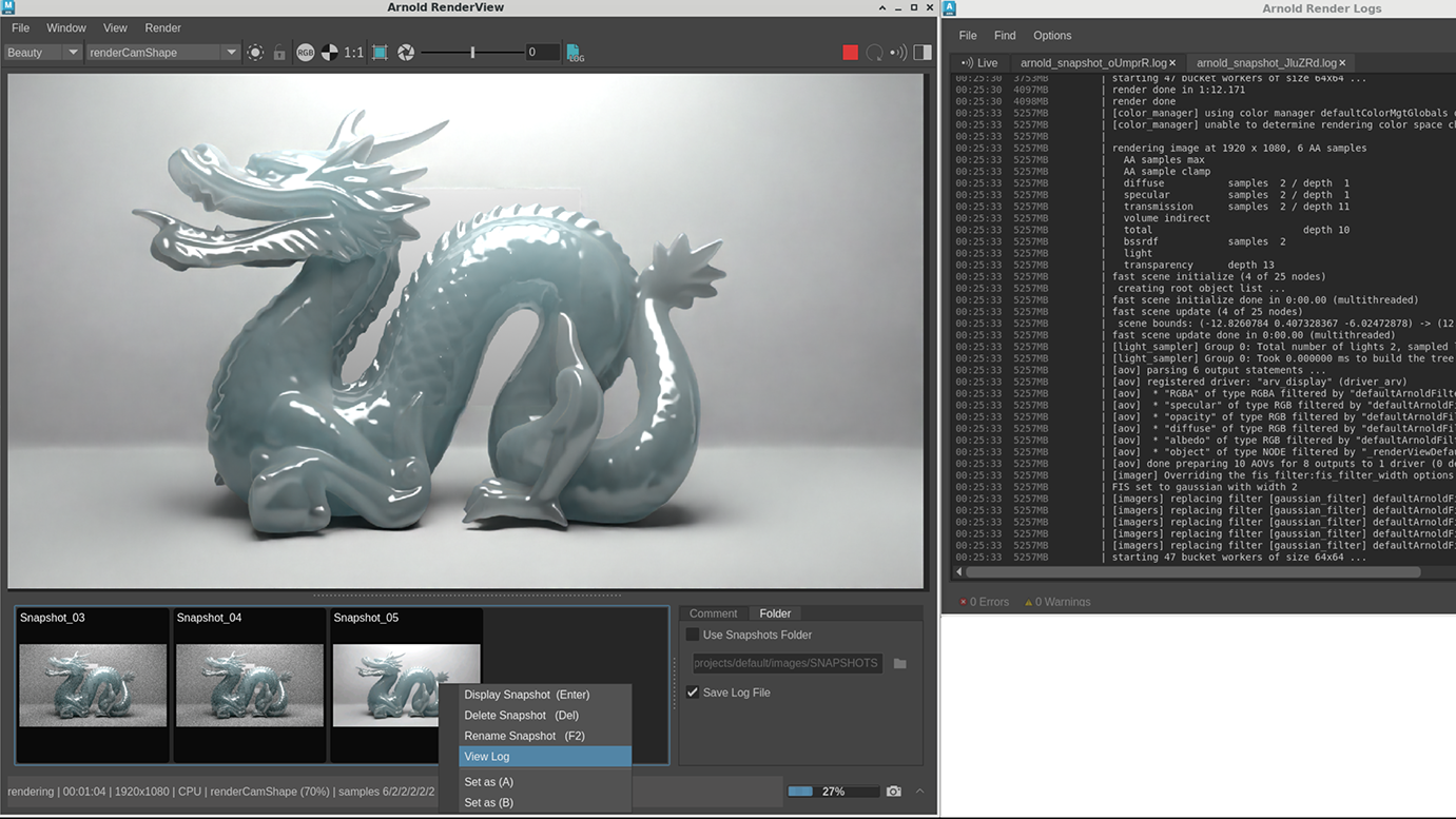

Render logs can now be saved with snapshots in Arnold Render View
When saving snapshots you can now save the current render log and view them in the Arnold Render Logs window (ARNOLD-12266)

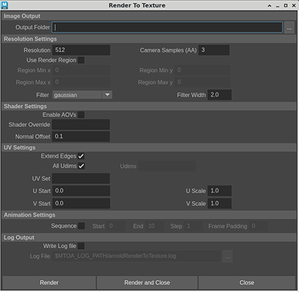

Render To Texture now supports USD stage selection
Rendering photometric (IES) lights and mesh lights using Global Light Sampling is now higher quality, using the same render settings and taking the same render times.
Users can now use Render To Texture on nodes inside the Maya USD stage. The UI has been improved to make it easier to use (MTOA-2180)
