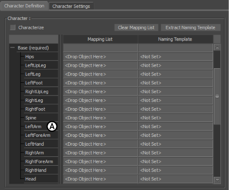

Switch to the Character Definition pane and view the Mapping List. Expand the Base (required) group of slots.
Character Definition pane A. Base (required) objects

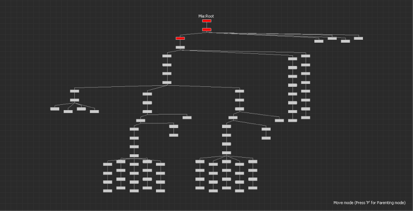

Character hierarchy in the Schematic view
You may find it easier to select bones using these nodes in the Schematic view.
For example, if you select the left thigh bone in your character model, you would Alt-drag it into the LeftUpLeg field in the Mapping List.
Repeat this step until you have dragged all of the required bones into the Mapping List. The Character mapping is now complete.
Activate the Characterize option at the top of the Mapping List.
