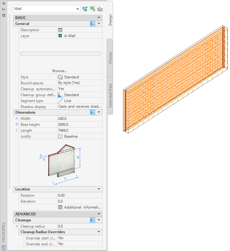

Wall in
	 AutoCAD Architecture
The following properties of an
  AutoCAD Architecture wall are maintained when it is imported to
  Revit:

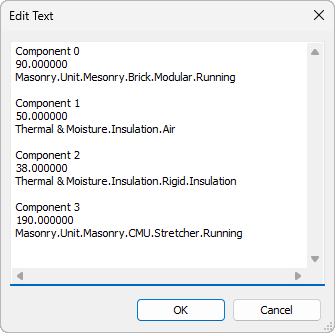

- Component Description: list of wall components, their materials and size
List of
		  AutoCAD Architecture wall components, materials, and sizes in
		  Revit
- Wall length
- Wall width
- Wall height
	 AutoCAD Architecture style name
- Type name (Wall)

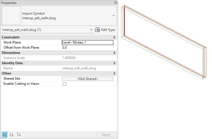

When you import an DWG or DXF file into
	 Revit, you can import all layers, all visible layers, or selected layers. After they are imported, layers can be selectively deleted from
	 Revit at any time.
  The imported drawing displays as a single import symbol.
- For more information about the imported objects, select the Import symbol, click Modify | <File Name> tab
Import Instance panel
 (Query), and select wall blocks to query.
  A query displays the object type, block name (identical to imported drawing name), layer, and style name, as applicable.
  To exit Query mode, press
	 Esc.
