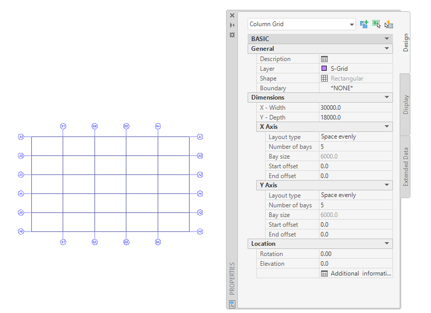

Column grid in
	 AutoCAD Architecture
The following properties of an
  AutoCAD Architecture grid are maintained when it is imported to
  Revit:
- Grid lines
- Grid bubbles
- Grid type (Column Grid)
- Grid bubble type (Multi-View Bock Reference)
- Grid bubble layer
- Grid line layer
