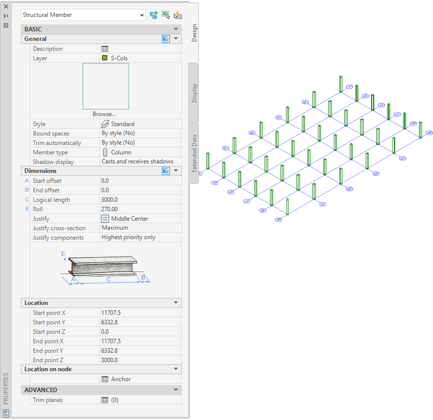

Columns in
	 AutoCAD Architecture
The following properties of an
  AutoCAD Architecture structural member are maintained when it is imported to
  Revit:
- Component Description
- Roll angle
- Member length
	 AutoCAD Architecture style name
- Structural Type name (Column/Beam/Brace)
- Type name (Structural Member)
The following properties are added to the imported member:
- Base level
- Base offset
- Instance scale (defined on import)
- Instance name (name of the imported DWG file)

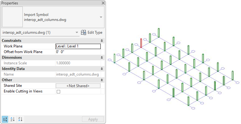

When you import a DWG/DXF file into
	 Revit, you can import all layers, all visible layers, or selected layers. After they are imported, layers can be selectively deleted from
	 Revit at any time.
  The imported drawing displays as a single import symbol.
- For more information about the imported objects, select the Import symbol, click Modify | <File Name> tab
Import Instance panel
 (Query), and select structural member blocks to query.
  A query displays the object type, block name (identical to imported drawing name), layer, and style name, as applicable.
  To exit Query mode, press
	 Esc.
  Note: The imported drawing can be exploded or partially exploded. To access the imported read-only
	 AutoCAD Architecture objects, perform a partial explode.

  A partial explode on an imported drawing allows you to display the individual object’s properties.
