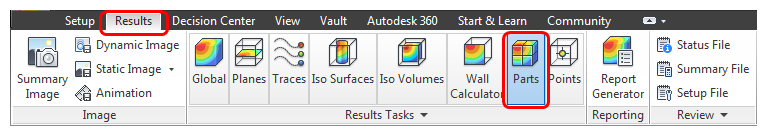

Click Parts from the Results tab:

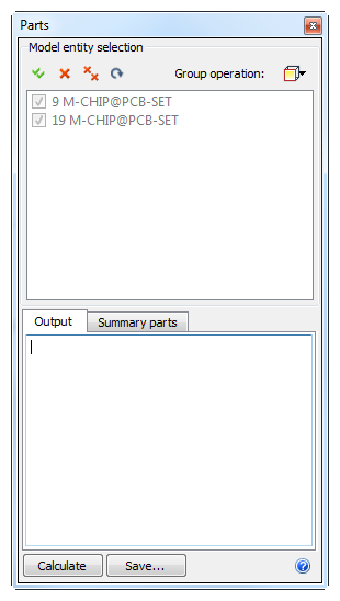

Click the Group operation button, and select the Medium Chips group.
To designate these parts as Summary Parts, check the box adjacent to each in the Model entity selection area.

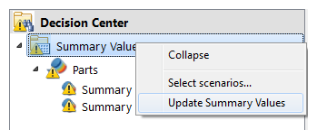

To start comparing results, click the Decision Center tab:
In the Decision Center, right click on Summary Values, and click Update summary values.

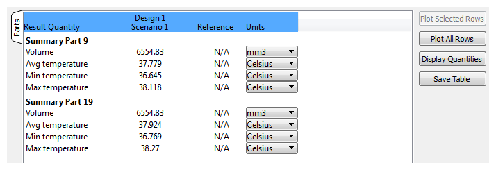

View the results table in the Critical Values tab of the Output bar
