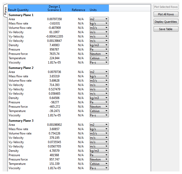

In this step, we will use Summary Planes and the Critical Values section of the Decision Center to assess the pressure at the inlet, throat, and outlet of the nozzle.

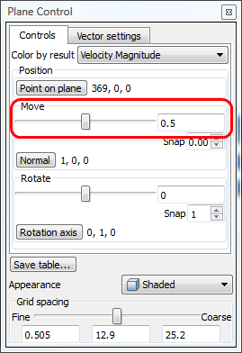

Right click on the plane, select Edit. Make sure the plane is at 0.5.
Make the three results planes Summary Planes by checking the Summary box for each:

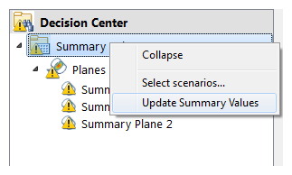

To start comparing results, click the Decision Center tab:
In the Decision Center, right click on Summary Values, and click Update summary values.
Congratulations! You have completed the exercise. Click here to return to the Tutorials Title Page.
