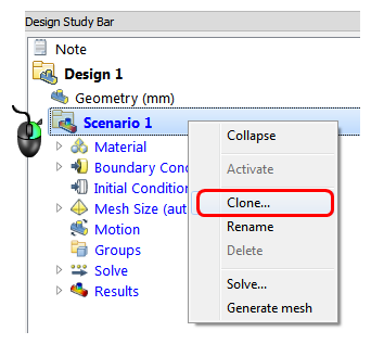

We will run a scenario with reduced inlet velocity values. To do this, we will copy the original scenario (using the Clone function), modify the inlet boundary condition on the cloned scenario, and then run it.
The Clone function is very convenient because it copies all of the settings in the Scenario. We will only change two settings, and use the others as specified.
To clone the scenario, right click on it, and click Clone...

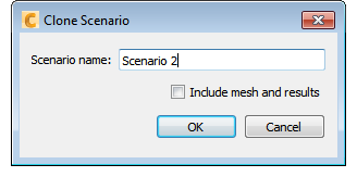

When prompted, assign a unique name to the scenario. Ensure that Include mesh and results is unchecked because we will run the cloned scenario with new settings.

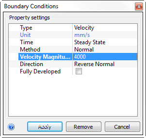

Click Boundary Conditions from the Setup tab:
Change the inlet velocity boundary condition by selecting the two inlets and changing the velocity on both to 4000 mm/s.
