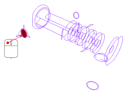

Left click on the plane, and click the Surface Align icon. Select the inlet surface.
To make the plane a Summary Plane, click Make Summary in the Planes context panel:

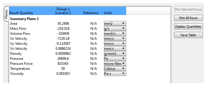

To start comparing results, click the Decision Center tab:
In the Decision Center, right click on Summary Values, and click Update summary values.
In this example we used the Summary Planes to extract data on a single analysis. In the following steps, we will create an additional scenario, and compare them in the Decision Center.
