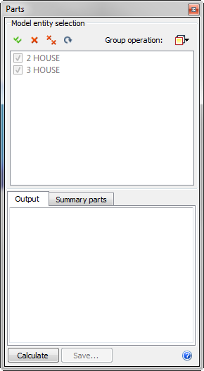

Click Parts from the Results tab:
Select the two houses.
Check the box adjacent to each part (in the Model entity selection area).
