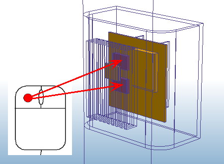

Hide the outer air, case, and inner air (if they are showing).
Select the two chips on the board.

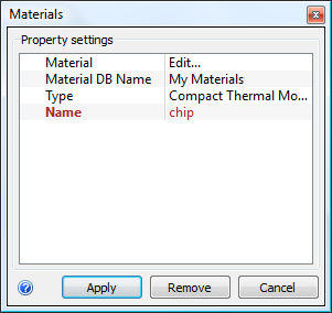

Open the Materials quick edit dialog in ONE of the following ways:
Material DB Name = My Materials
Type = Compact Thermal Model
Name = Chip
Click Apply.
