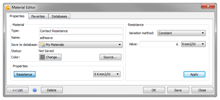

To open the Material quick edit dialog, click Edit from the Materials context menu:
Set the Selection Mode to Surface from the Setup tab:
Change the Type to Contact Resistance.
On the Material line, Click Edit...
Enter the name adhesive in the Name field.
Select My Materials from the Save to database menu.
Value = 6 K-mm2/W
Click Apply.
Click Save.
Click OK.
