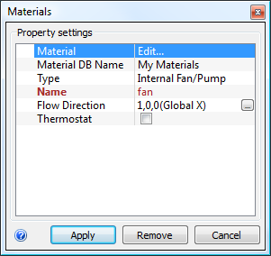

Open the Materials quick edit dialog in ONE of the following ways:
Material DB Name = My Materials
Type = Internal Fan/Pump
Name = Fan
Click the X button on the Flow Direction dialog.
Click Apply.
